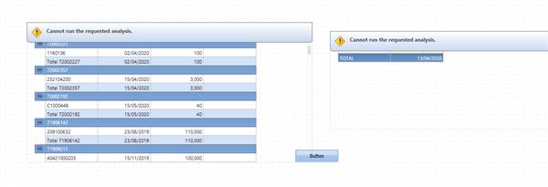

Thanks for your solution. I already try it and the cube contain same data for all lines. But its in case in 1 axes or 2axes with relationship.
In my case, i want to make data view with 2 axes(entity)-no relationship. for example, like this.
When i applied for adding date for all lines, like your solution. Then the system appeared an error.
Any solution for this case? I just want to use 2 entity without relationship

Dietmar Jeschkeit
Hi
@Dimas Prayogo
sorry for the late answer. It all depends on your structure of the cube. Here is an example where the date cube is only on one Dimension (dummy) and it is in the dataview with 2 independent dimensions by row.
So maybe you can provide more Information? And what is your final goal you want to achive ?
