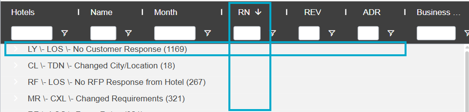

Hi, any how to show subtotals on collapsed groups in a flex grid and in general to show totals when expanded?
What are your group display type settings?

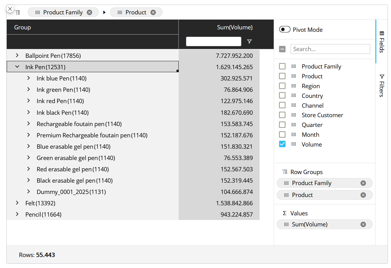

Hi, you can define the display of sums in the field "values":

I am correcting you :) It works in non-pivot mode as well. You just got to drag your values in to the Values field:

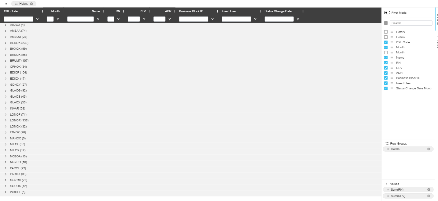

Good to know that it should in theory work.
But then I don't understand why it doesn't work in my screen.
