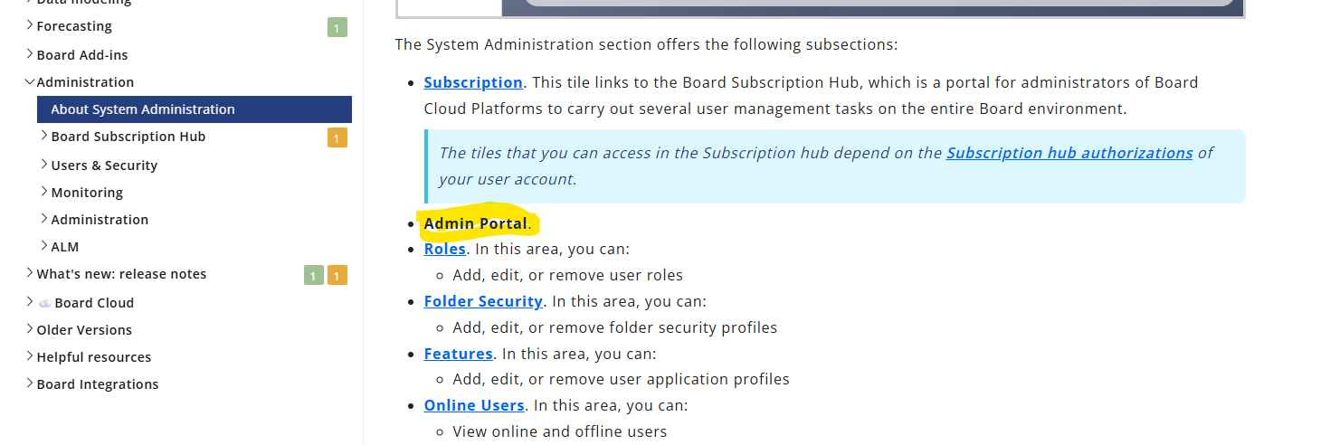

Hi, so there are same pages missing in the manual, mayby links that hasn't been updated.

Hi Gustavo, There may have been a glitch can you please try again or use the following link and see if you are able to access the page
https://help.board.com/docs/about-system-administration
Cheers
Dom
