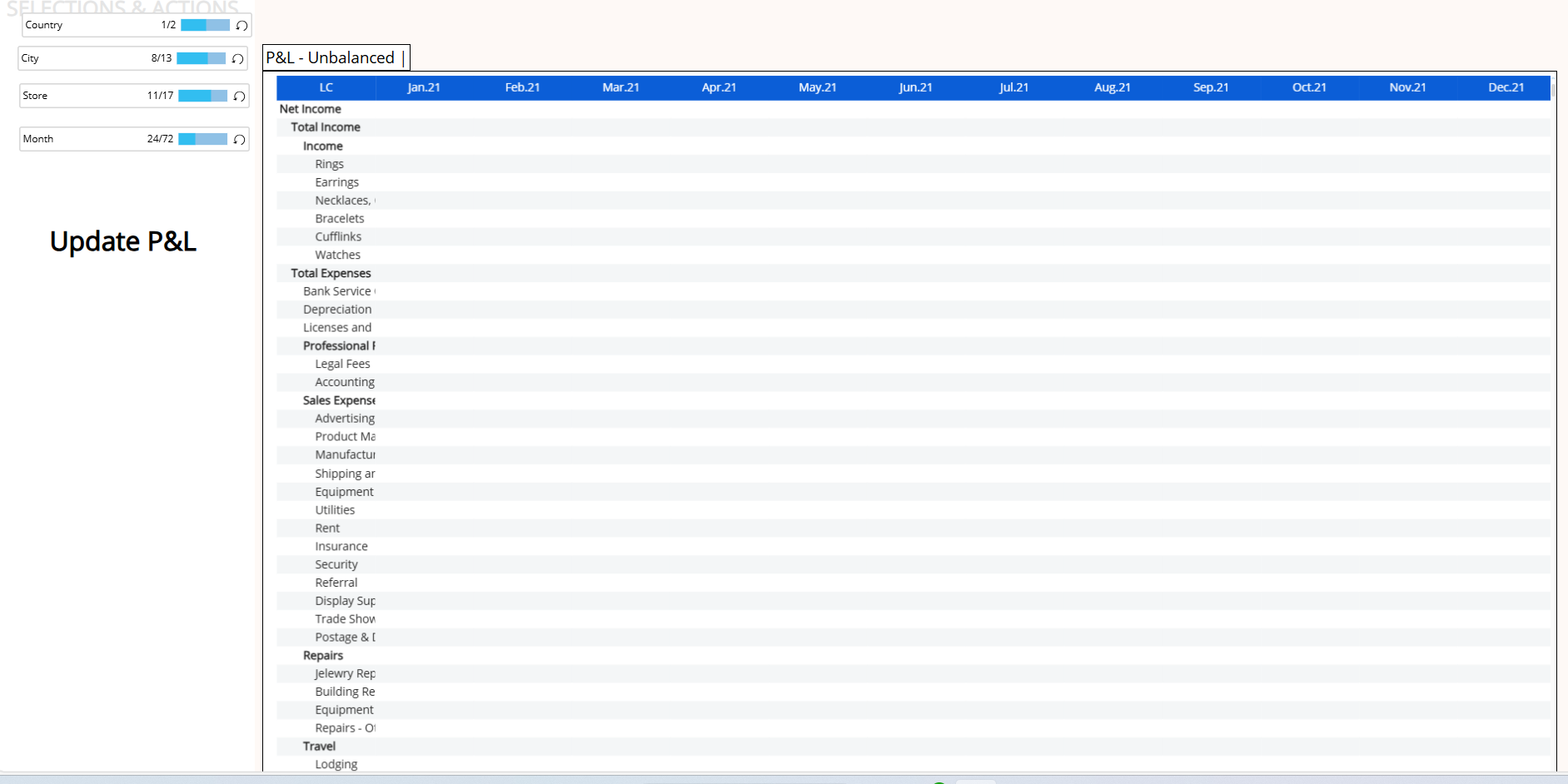

Hi, I am not able to see the data coming up in module 212 of B12 level 200 om P&L screen after clicking update P&L, and the cube-UTIL - DE - Product - P&L Mapping dataflow is showing 0.

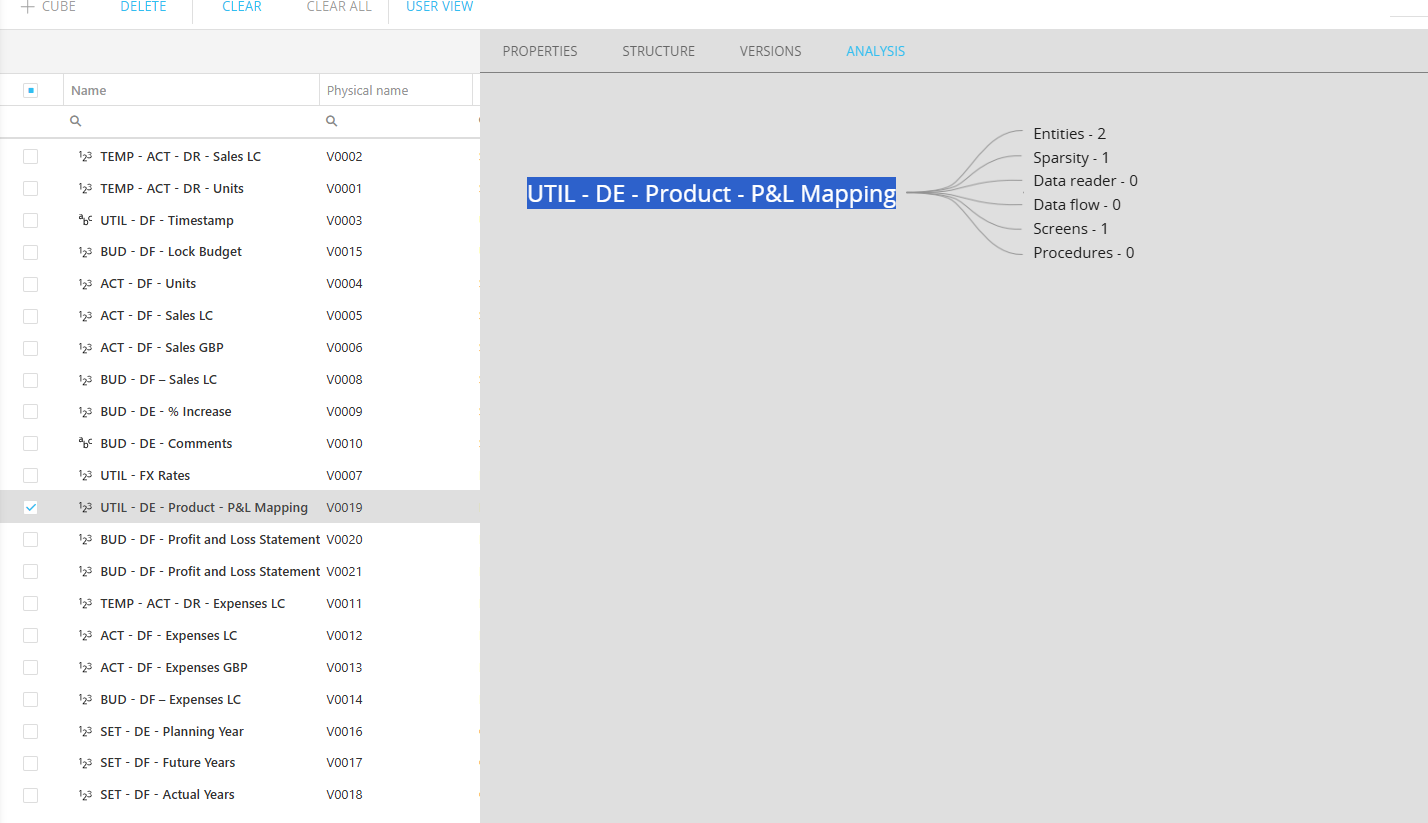

Hello Harika, I understand that youβre unable to see any data in Module 212 on the P&L screen after performing the Update P&L action, and the related cube is showing zero records.
Could you please share screenshots of the data model procedure and the capsule procedure for BUD - Consolidate Budget into P&L?
Additionally, please provide a screenshot of the dataflow layout configuration for the Profit and Loss Statement β Budget screen.
Lastly, could you confirm whether the Update P&L button is correctly linked to the BUD - Consolidate Budget into P&L procedure? Regards, Nial Smith

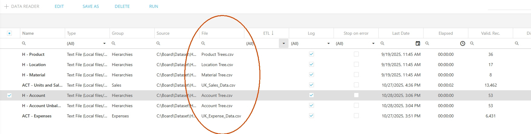

Facing the same problem, I found a solution. Reason was a mistake in chapter 209. Maybe for someone it's usefull someday. Check if you have connected to all files inside the data reader menu: Look at screenshot! I forgot connection to Account Tree.csv for "H - Account Unbalanced".
