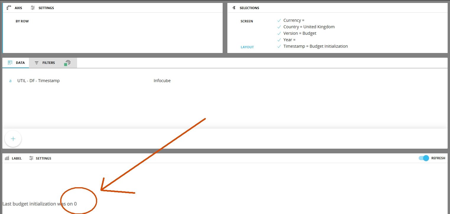

My Timestamp "BUD - Initialize Budget" is always = 0 (after initializing the Sales budget). All other timestamps are in function as expected.

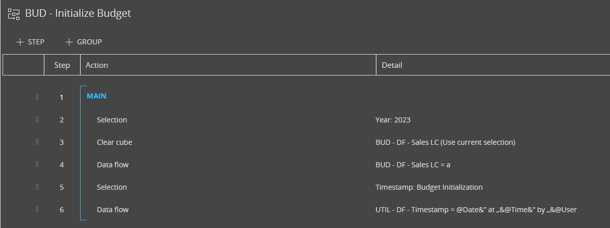

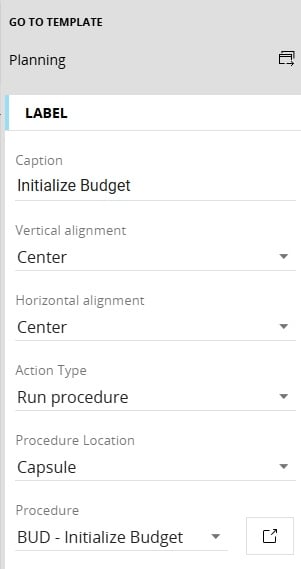

Here what I see after creating the screens and procedures:
- Before first time clicking "Initialize Budget" in my "Sales Planning" Screen the "Last Budget initialization" was = N/A. (> OK from my point of view) - Then I click "Initialize Budget" - Budget i loaded correctly (figures exactly as shown in the lesson) - Now the "Last Budget initialization" is = 0 (and not date + name)

I found the reason:
In the german version of the 200/206 lesson stands "
@Date &“ at „&@Time &“ by „&@User
correct is
@Date &“ at "&@Time &“ by "&@User
@colleagues from board: You should correct this!
jpg attached
