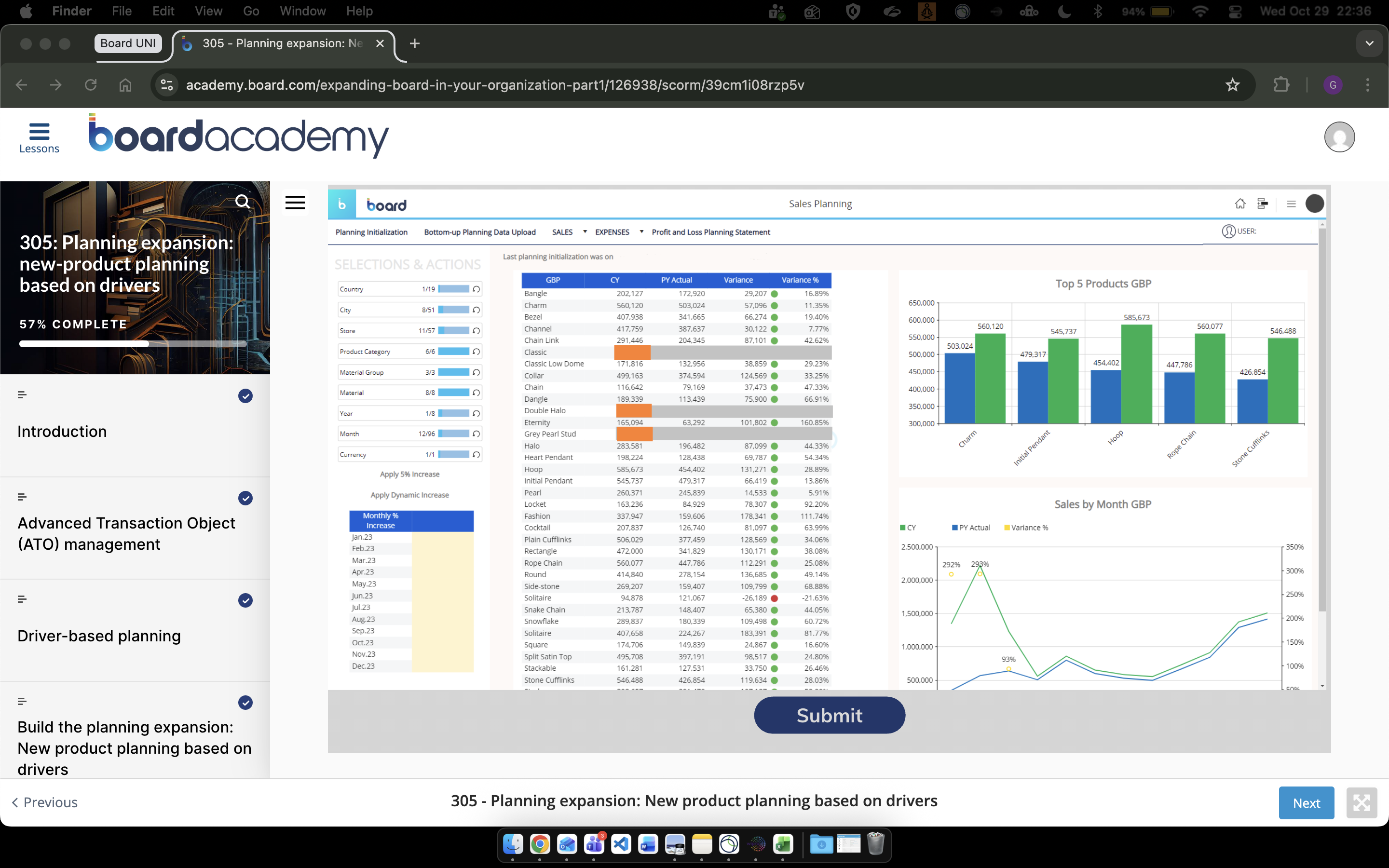

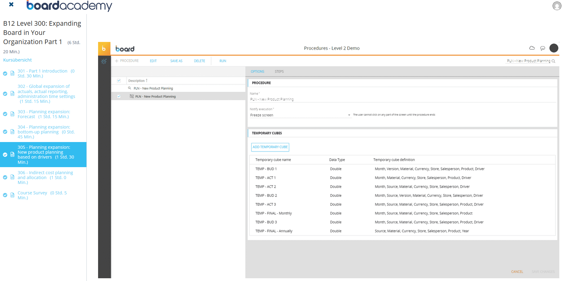

Hi everyone, I’m stuck in Functional Test Question 1 for Level 300, Module 305.

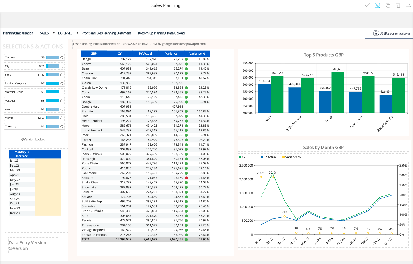

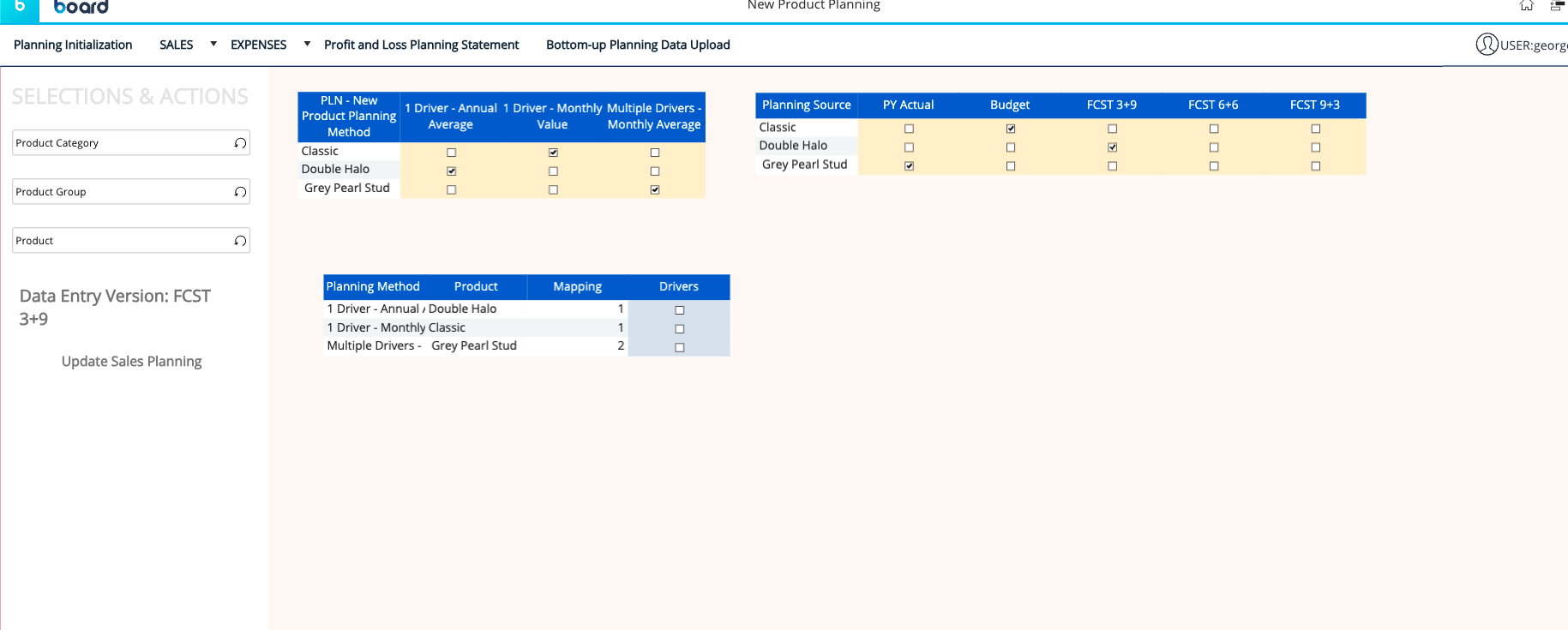

Despite reviewing the steps multiple times, I’m getting correct results for Classic and Double halo but any information regarding Green pearl stud is not visible on the Sales Planning page.
I have tried running the planning initialization again, and reviewed the selector and page selections.
What could be the issues?
Attaching a few screenshots that are related to this module.

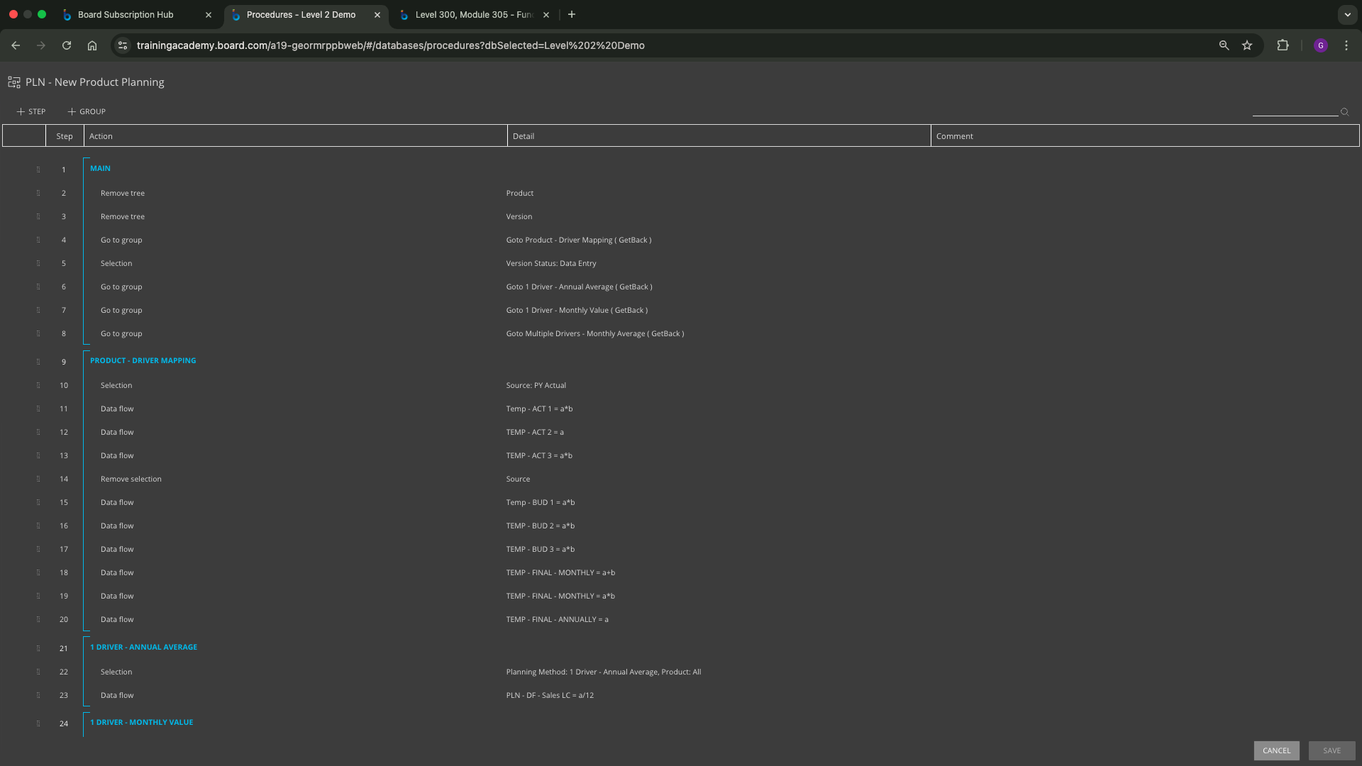

Hi @George Kuriakose Jr

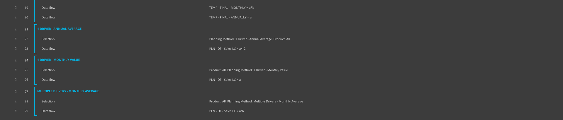

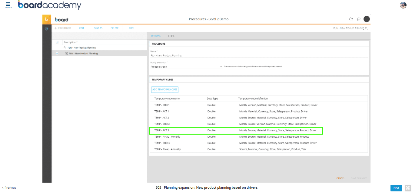

We've noticed that, as per the step 'Build the PLN - New Product Planning Data Model Procedure', the temp cube TEMP - ACT 3 is wrongly configured in the cube PLN - New Product Planning.
You can find the correct configuration either in the module itself or in the screenshot you will find in this post.
Once you have corrected it, re-run the procedures from the screen as advised in the module, then proceed with the Functional test.
Hi Marcus, Thank you for the respose. the issue has been resolved.

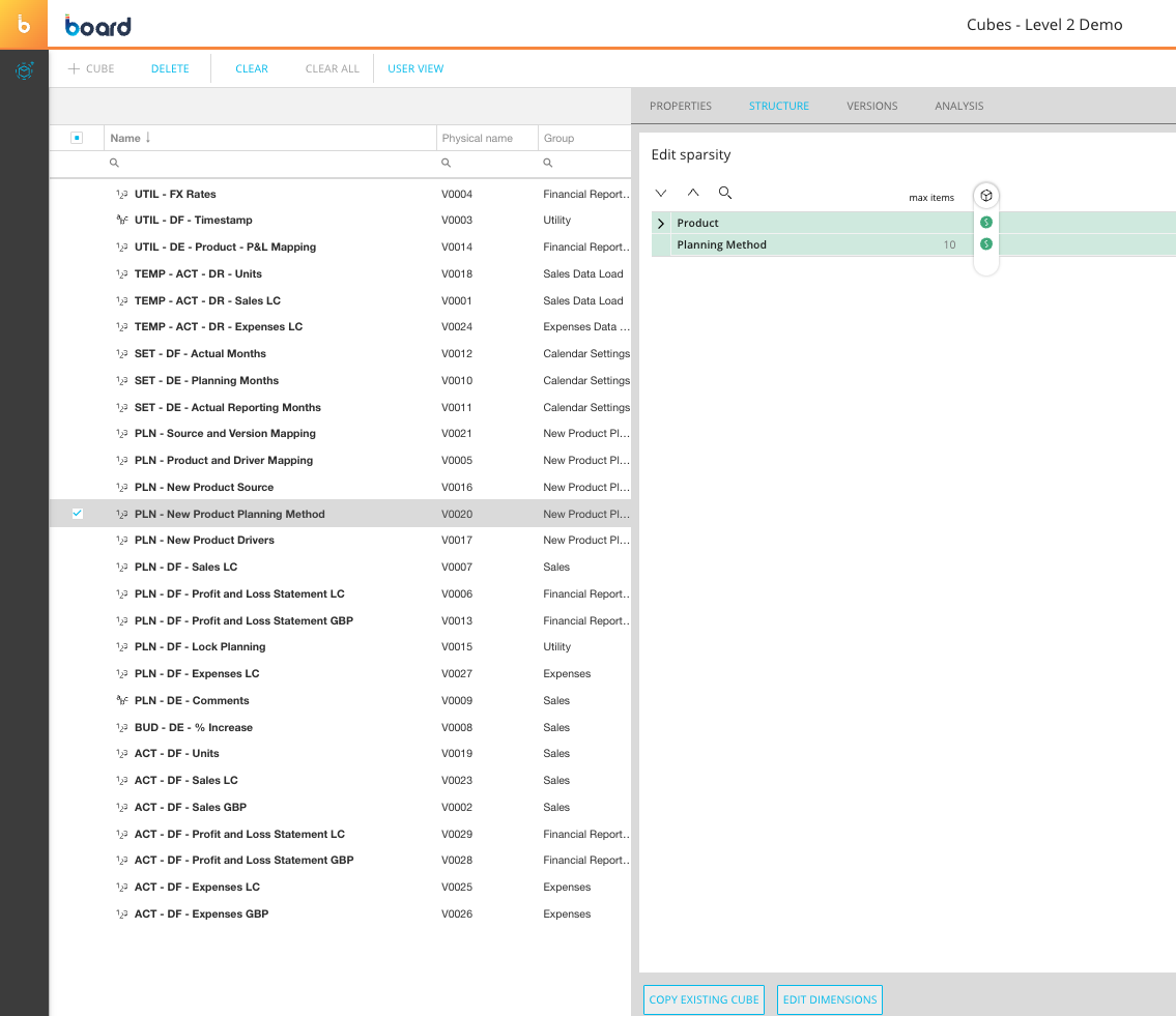

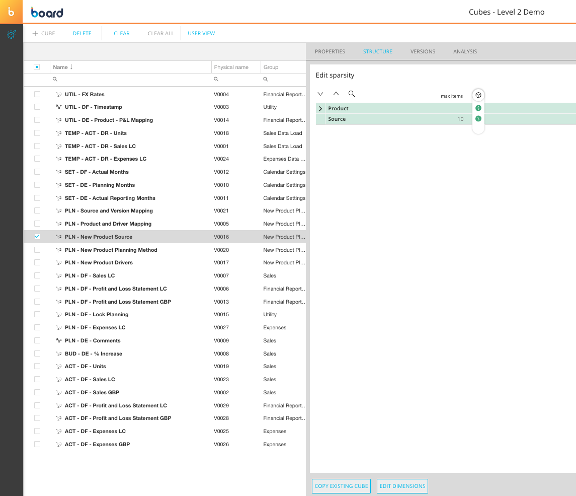

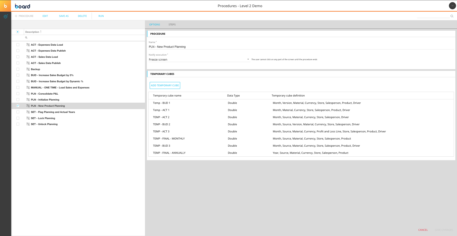

How it should be is this and I can not see a difference. I have a similar issue but I only see "Grey Pearl Stud" and not the other two. Checked temp cubes several times.
Would be helpful if the real numbers would be visible somewhere, just to know if the values you got are fine.
