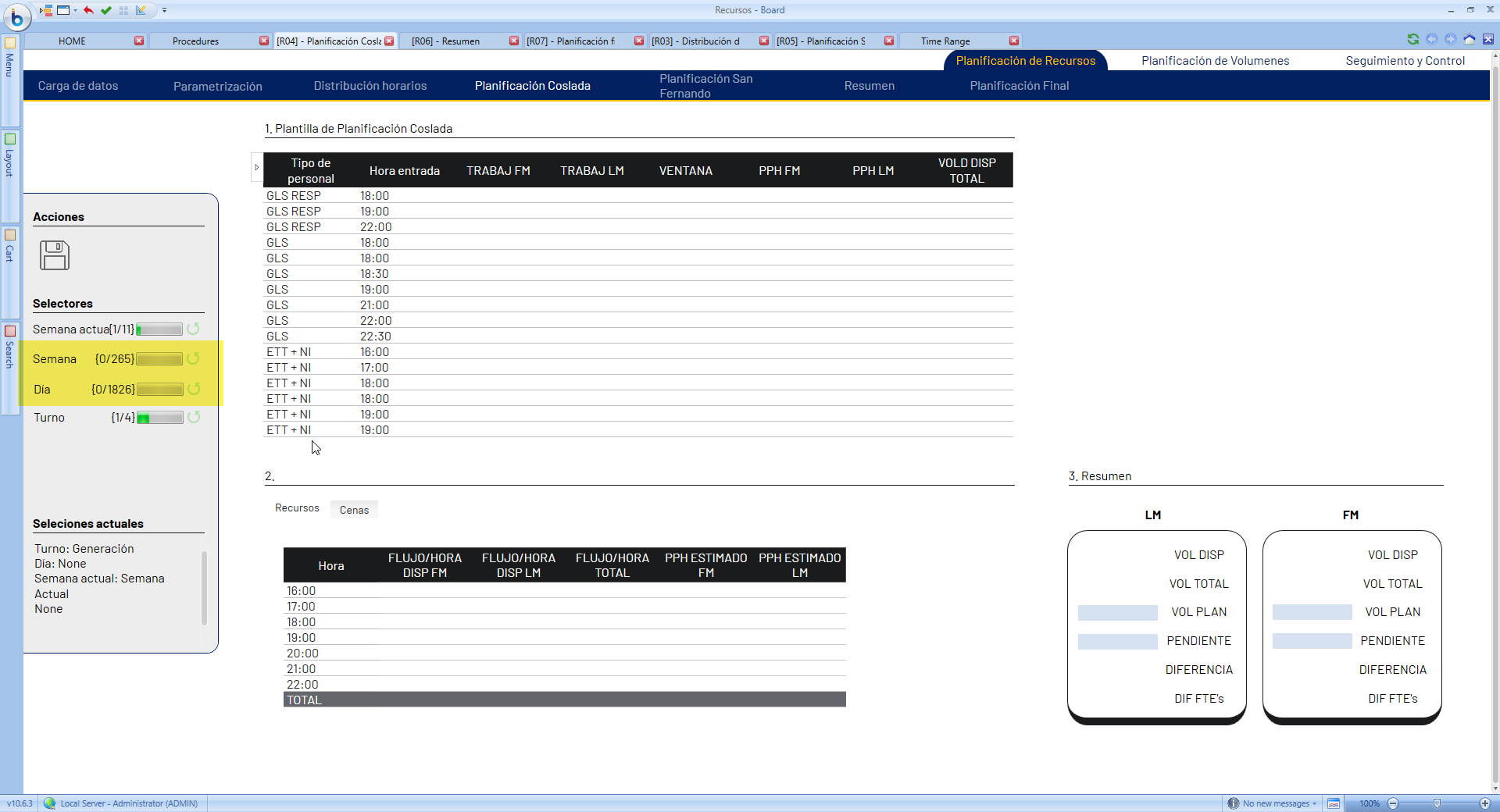

Nevertheless, I am experiencing an error on the screens when the day selector and the "actual week" selectors interact between each other. Specifically, when there is a selection over day, and then I try to select a week from the "actual week" selector. It happens the following:
And while this is happening if I open the screen selections, it can be seen that there are 2 selections applied, 1 over day and the other over "actual week".
I realized that if I hit refresh when this happens, the issue gets solved, so I came up with the following solution, I put a label over the "actual week" selector that execute a procedure with an interactive selection over this entity that ends with a refresh, and this works fine. However, I would like to know why this is happening and if it is possible, how to solve it.

Hey there. I think this is happening because "day" is at the lowest level, and a selection on day likely overrules the selection on week. In other words the selection on day probably needs to be cleared before you can select a different week.
I've had similar things happen in a product hierarchy - so I don't think this is specific to your use of custom time entities. I suspect others users have also experienced this. I'm not sure if it can be considered an error, as it is likely just the symptom of incompatible selections.
