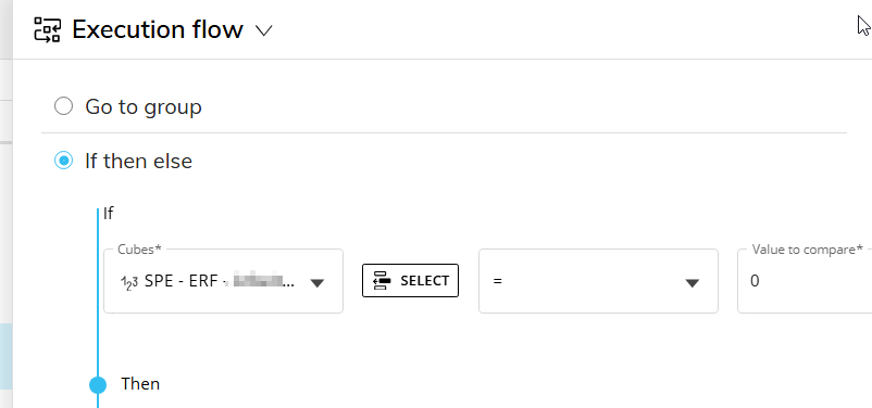

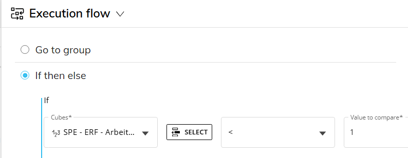

- I have one cube having four dimensions: {year, username, process step, process role}.
- The if-then-else step checks:
- if cube = 0 → Then GroupA → Else Group B.
- no select is set here
- The select context when the procedure starts is one cube cell. Each dimension is selected on one member only, e.g. Year = 2026.
- The cube has already values existing on the slice previous Year = 2025 for the user running the procedure.
- When the procedure runs, the debugger shows the correct context selection and using debugger layout view, i see that the cube's value used by the If-then-else is 0´. So i expect the step to drive into GroupA.
- However, the if-then-else step doesn't run into GroupA but into GroupB.
- If i delete manually the value stored on the slice previous Year = 2025 and run the procedure again, then the if-then-else step does run into GroupA 😯. The same applies if values exist for other tuples outside of the procedure step selection context…
So i am a bit lost here. I was thinking i can use the if-then-else on a very dynamic way playing on the context selections.
Right now, i have the impression i must define as many if-then-else steps as the combinations (tuples) i drive the business process on 🤔. I hope I am missing something.
