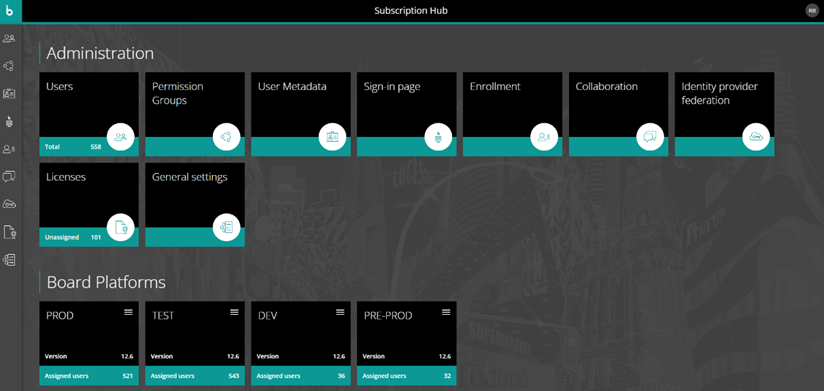

The cornerstone of the modern security configuration in Board is the Subscription Hub, it provides a central repository for storing user credentials and granting permissions to the different environments.
3.2.2 What can you do in the Subscription Hub?

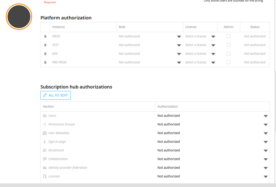

In here you can create users, specify their key details and grant or deny access to each of your environments quickly and simply by allocating the license you wish to give the user and then specifying a server role for each instance you want them to have access to.
For admin users you can also grant access to different admin functions such as the Admin Console for each environment and even the different areas of the Subscription Hub itself if the user is to be a system administrator.
Figure 1– The home screen of the Subscription Hub showing the different admin areas and environments

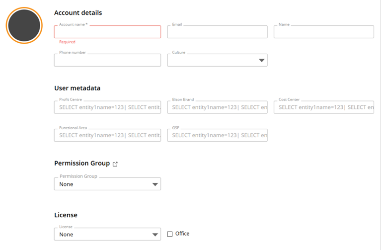

Figure 2– Creating a New User in the Subscription Hub
Figure 3 Granting Access to Environments & Admin Functions

One of the options the Subscription Hub gives you is the ability to create custom metadata fields which will form part of a user profile, you can create as many of these fields as required and the contents can either be free text or selected from a predefined list of values.
The contents of these metadata fields can then be used in your database security using a simple custom script, where required multiple metadata fields can be referenced and these can be combined freely with the other methods of security we’ll discuss.
For example say we were to create a custom metadata field called Profit Centre, in this field we could place a list of Profit Centre codes, comma separated, so for user Bob we enter “1234, 2345, 3456”, we can then reference this list of codes in our database security using a custom script which looks like this “SELECT Profit Centre = @var (Profit Centre)”, Board will then resolve this as “SELECT Profit Centre = 1234, 2345, 3456” and apply that selection to the database any time Bob logs in.
Alternatively we can amend the configuration slightly and put the entire select statement in the Profit Centre metadata field, so the field in the Subscription Hub would contain “SELECT Profit Centre = 1234, 2345, 3456” and the custom selection in the database security would then only need to be “@var (Profit Centre)”, in this way we can leave the metadata field blank for users who don’t need this restriction and only populate it for those who do.
Quite how you configure it is up to you, as long as your custom select resolves to a valid SELECT statement once the metadata has been substituted in, the security will be applied.
If needed you can create multiple metadata fields and reference whichever ones are required in the custom selection, for example if we added a second field called Product and for Bob we entered “SELECT Product = ABC1”, we could then have a custom selection which looked like:
@var (Product)”
Board would then resolve both substitution variables and apply both security selections for Bob every time he logs into that database.

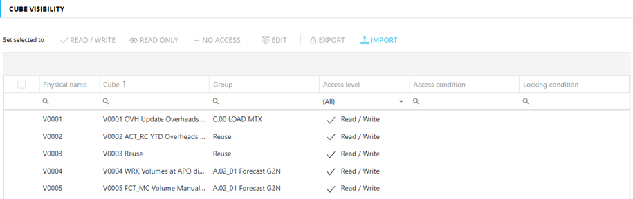

Under Database Security at the bottom is the Cube Visibility section, in here for each profile you can specify which cubes should be visible to the user and which should be available for data entry, as well as being able to simply select the different cubes which should be available for each, you can also give selective access to a cube, based on defined criteria involving one or more other cubes.
Figure 6 Configuring Cube Visibility

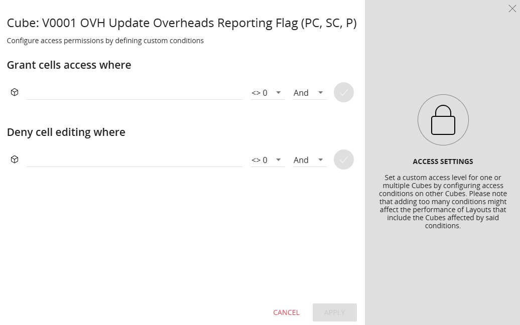

To specify this granular access configuration double-click on either Access Condition or Locking Condition and you’ll see a dialog similar to this one:
Figure 7 Specifying Granular Cube Access
In here you can choose one or more cubes along with a corresponding check to use to determine which slices of the cube the user can see or write to, if we use the cube we created in the previous section say, we could limit Bob’s access to certain cubes so that he could only see or write to the Products we flagged earlier, this means that for other cubes he’ll be able to see all Products.
This type of setup can be useful where you have certain cubes containing highly sensitive data which needs to be tightly controlled in terms of who can view or edit it, payroll data for instance, other data such as the company balance sheet might be deemed much less sensitive and the same employees who can see little or none of the payroll data might be permitted to see the entirety of the balance sheet.
